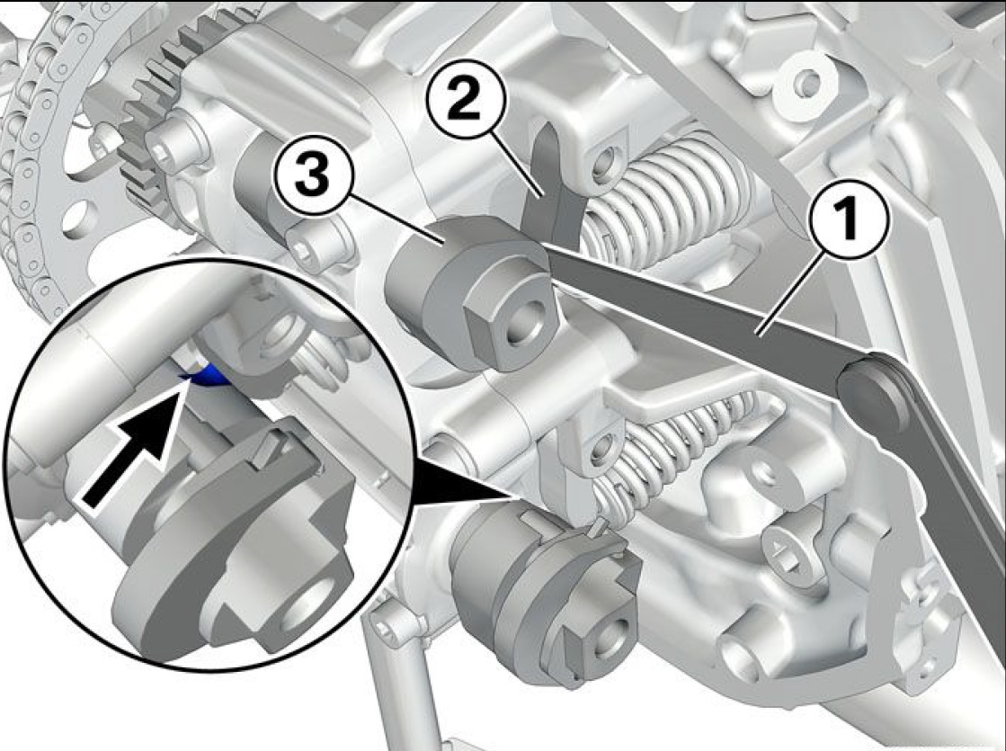

The thing is that I have all the needed tools made myself but I am not yet so 100% sure if they will work as they should.
The Tensioner I built regarding your video instructions.
For checking the parallel flats I made a 3D printed version of the tool which fits identical as the original metal one:
https://www.bmw-bike-forum.info/downloa ... p?id=35408
https://www.bmw-bike-forum.info/downloa ... p?id=35409
For locking the engine in the right position I bought this one and reworked it (I flattened the thread so it will fit into the hole). It snaps now in the 8mm holes and locks:
https://www.ebay.co.uk/itm/283463635011 ... oterUpdate
Thanks again for your absolutely fantastic videos, thats a huge help!

Just an observation of the first picture. The laser etched block is inward toward the other cam and for a proper check of timing, the laser marks need to be outward, apart from each other.

Yes, that's right it wasnt the position to check the clearance. The photo is just to show how it fits on the cam.
